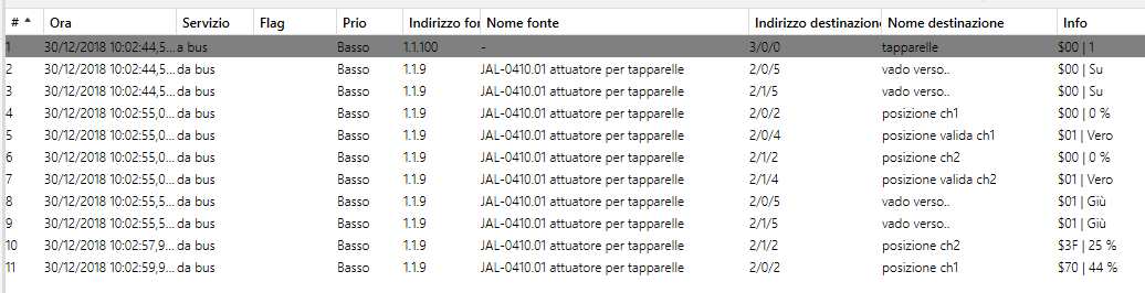

The attached image shows the sequence of operations required by the actuator, CH1 and CH2 channels. With scene 1, i requested the actuator to place CH1 at 44% and CH2 at 25%.
At the Power-On the actuator does not know the position of the shutters, therefore for each of them positionValid = false, then executes the content of "if (! PositionValid)" bringing the shutters to the reference position 0% obtaining a valid position from which start to reach the desired position from the scene.
