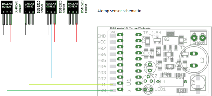

I have connected them as described in the schematic attached.
I flashed the 4temp v2.02 hex without watchdog enabled, although there is watchdog related code found in source, it reboots every x secs when enabled, so disabled it.
Programming works, I see the group addresses coming in, but with static/wrong values as described.
Sesnor on P0 and P1 show higher than normal static values, they don't change when temp change, at least not over a minute, P2 and P3 sensor always display 0 value.
I selected 0...5V als sensor type in ETS4, for DS18S20.
Can I debug this via serial/eclipse or something?
I can try to attach my scope to see if there is data on the P0_0 - P0-3 pins.
I will also swap my LPC to make sure it's not damaged electrically.
Any other suggestions?

- 4temp ts-dil schematic.png (49.5 KiB) 9480 mal betrachtet

Wire lengths are 30cm's it's still on the workbench/test lab.

Our circuits are nearly all the same, only fit in different cases.
Your circuit is ok, it sent anything.
connection is also ok.
